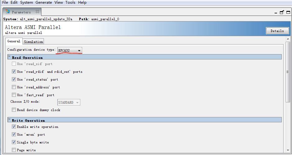

A question about Altera ASMI Parallel IP
I used Altera ASMI Parallel IP for online programming.
I generated it with "EPCQ32A" setting, the core work error. All data are "0x00" in serial configuration device EPCQ32A.
But if I generated the IP core with "EPCQ32" setting, it's work right. All data in the device "EPCQ32A" are same with "config.rpd" file.
The other options had the same setting.
DesignTool: Quartus (Quartus Prime 17.1) Standard Edition
OS : Windows 7 SP1 (64bit)
FPGA: Cyclone 10 CL080Y
Configuration Device : EPCQ32A
The IP user guide seems simple enough, but I cannot get the solution.
I really appreciate any help you can give.
Thanks!
Chenliang

    Hi Liang Chen,
    Are you saying that with the "EPCQ32" setting, it is able to work on design with EPCQ32A flash? If it so, by right it shouldnt be.
    May i know have you tried on the other quartus version?
