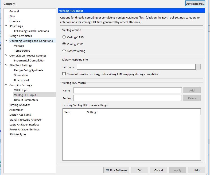

- Vicky1
Could you please check with Verilog-2001 version? older version of verilog might not supported.
'Assignments' Menu-> 'Settings'.
Vicky
- AAlas3
Yes it is Verilog 2001, I think this happened because of the escaping mechanism in Verilog (\ " ")
