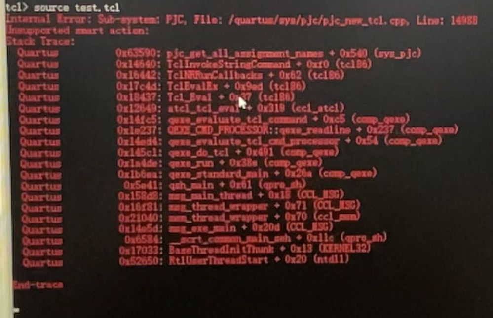

A BUG when using Quartus Prime Pro 20.1 tcl terminal
when running the command
get_all_assignment_names -module fit
the software will report an error and automatically launch
Error information:
quartus internal error sub-system:PJC File: /quartus/sys/pjc/pjc_new_tcl.cpp Line:14988
Unsupported srart action:
Stack Trace:

        Yes, this was a bug when I use this command. I have file this bug to the internal engineer and I'll get back to you as soon as possible.
