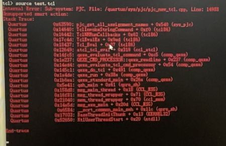

4 years agoA BUG when using Quartus Prime Pro 20.1 tcl terminal
when running the command
get_all_assignment_names -module fit
the software will report an error and automatically launch
Error information:
quartus internal error sub-system:PJC File: /quartu...

4 years agoSorry, I have misunderstood that module fit is a name.
Yes, this was a bug when I use this command. I have file this bug to the internal engineer and I'll get back to you as soon as possible.

One workaround for now is don't use this Tcl command or use it at a command line tool like quartus_sh -s instead of the GUI Tcl console.
This problem is scheduled to be fixed in a future release of the Intel Quartus Prime Pro edition software
