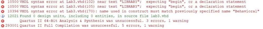

10500 Syntax Errors
Hi All,
I've been slowly knocking things out of my error list, but I'm stuck on these. Thanks in advance for any assistance.
My code:

    Hi Sami,
    1. Include begin and end Behavioral; statements in Counterde1 entity(Line 100).
    2. Line 103, USE ieee.STD_LOGIC_1164.all; not USE ieee.STD_LOGIC.all;
    3. Line 106, use altera_mf.all; not use altera_mf;
    4. Line 76 space between downto 0.
