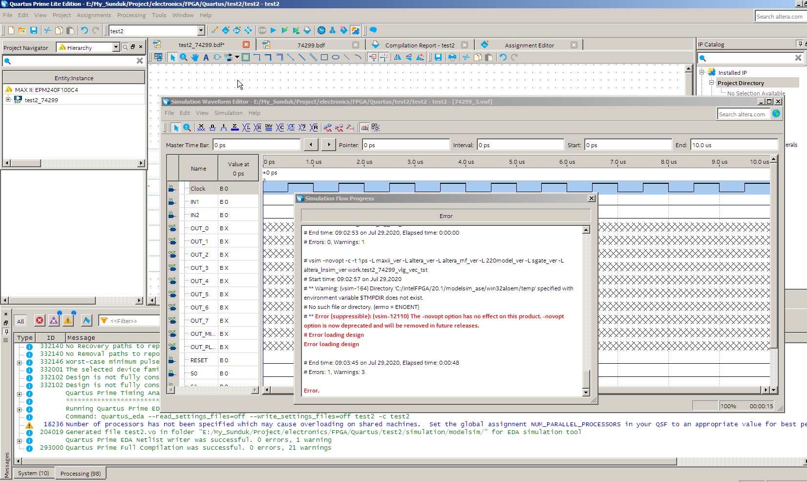

* Error (suppressible): (vsim-12110) The -novopt option has no effect on this product
# ** Error (suppressible): (vsim-12110) The -novopt option has no effect on this product. -novopt option is now deprecated and will be removed in future releases.
# Error loading design

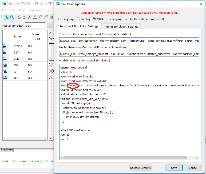

    It's a bug. In the Simulation Waveform Editor, choose Simulation Settings|Simulation Options and delete -novopt following vsim in the Model Script (and save the changes).
    • ABDULHAKIM_LUKWAGO's avatar
      ABDULHAKIM_LUKWAGO
      Thank you. it worked. but guys should know that what they are deleting is a text
