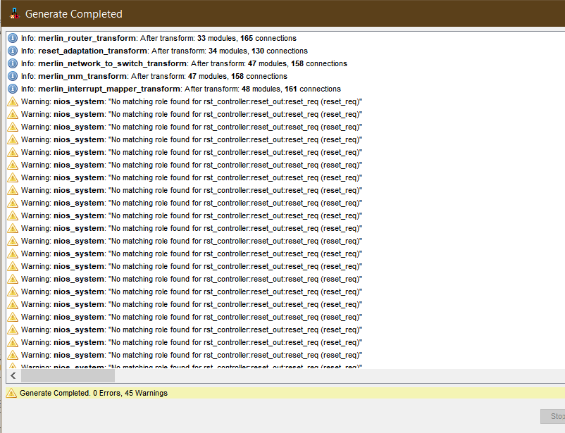

I wish to develop nios system using qsys. I generate and get these warnings message. How to solve this problem?
Warning: nios_system: "No matching role found for rst_controller:reset_out:reset_req (reset req)"

    Would you be able to share a screenshot of the platform designer to see which IP are being used and connected?
    Also which quartus version are you using?

    Have you tried to recreate your Qsys from fresh again and the reset module will be created and added for you by default, and you regenerate it again. You can ignore the warnings if your Nios is running.
