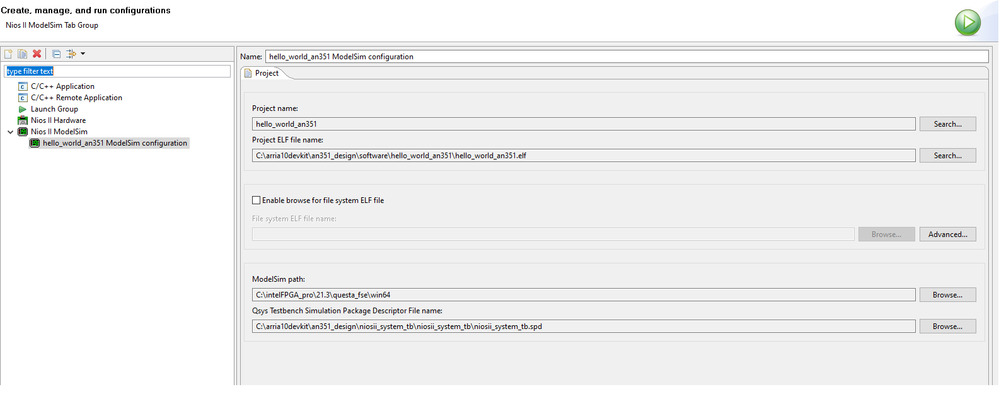

I am using Quartus PRO 21.3,
I followed the document step by step. it did run the simulation on the Questa.
Here is the Transcript console dump. the problem is when I add wave signals. it couldn't find any signals. always says, No objects found matching
add wave -position insertpoint sim:/niosii_system_tb/niosii_system_inst/*
# ** UI-Msg: (vish-4014) No objects found matching '/niosii_system_tb/niosii_system_inst/*'.
It is very likely that I missed something. could anyone give me some hint to trouble shoot my simulation environment. appreciate your help.
