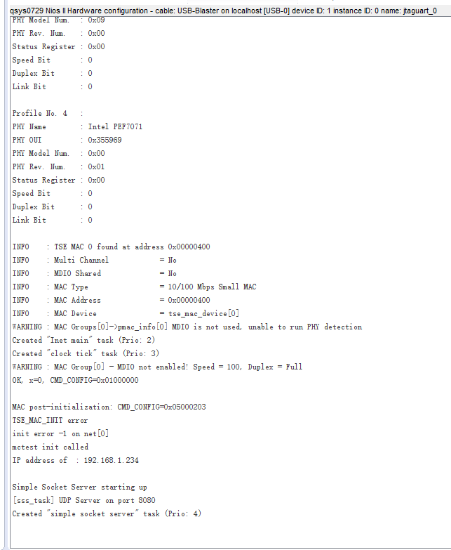

i'm using quartus prime -18.1 version software.while executing NIOS sample socket server application on Cyclone 10 on my own board .i use msgdma IP for TX & RX between TSE MAC & SDRAM. when run as nios hadware,it's giving error like: "TSE_MAC_INIT error".
the nios system with sgDMA can work sucess on cyclone IV .we changed the FPGA to cyclone 10 LP with the same sdram and phy schmatic. I use Simple Socket Server template to build the software in eclipse and run ,then nios console is like the picture. i connect my PC to the board's RJ45 and fine configure the IP adress. the ethernet status shows connected, but i ping 192.168.1.234 failed.
