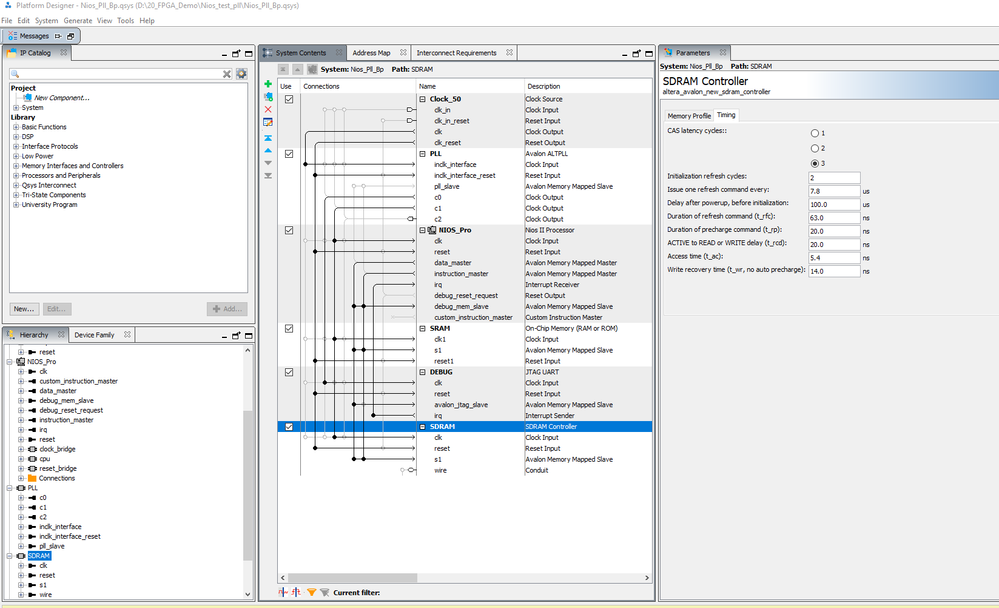

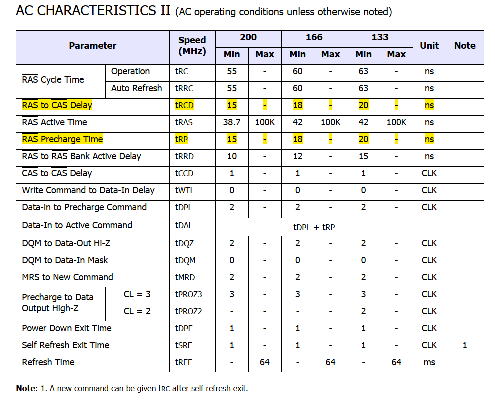

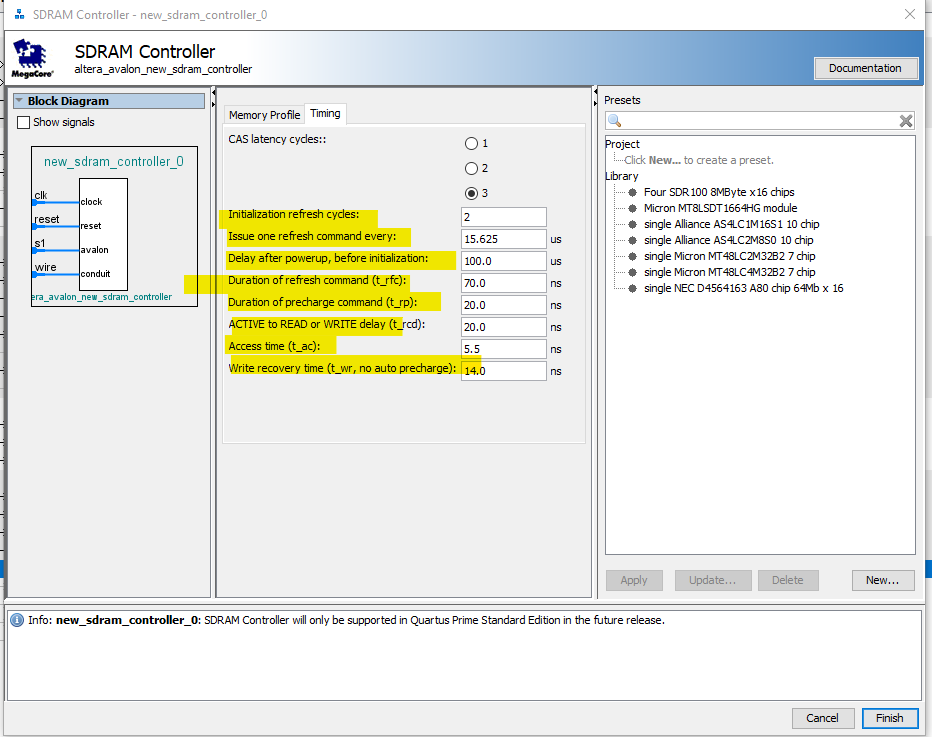

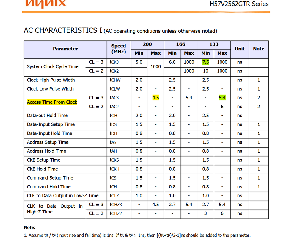

Could anyone help me to understand these parameters:
I want to add my memory but I am struggling a little bit with the timing since the datasheet has not had the same naming.
I am using the H57V2562GTR-75C running at 133MHz.
Thank you in advance
Hello, I managed to solve my issue, here are my values, it works for the moment, and the code is running from the SDRAM:
