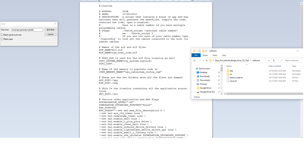

Here is a screen catch with both batch-script.sh and the directory.
in the .sh file APP_DRR = ./app.
but I don't have that directory in the /software/ directory.
I guess I missed a step or there was a failure I didn't notice during previous steps. could anyone give me some suggestions/hints.
which program or execution generates ./app directory in the project/software?
Thank you for the help.

- EBERLAZARE_I_Intel
I see that you are using Quartus 21.3? Have you install below thoroughly?:
https://www.intel.com/content/www/us/en/support/programmable/articles/000074066.html
- dsun01
Contributor
thank you very much, I guess I made mistake while install the wsl.
For temporary workaround, could you try using Quartus 18.1 version with the CYGWIN?
