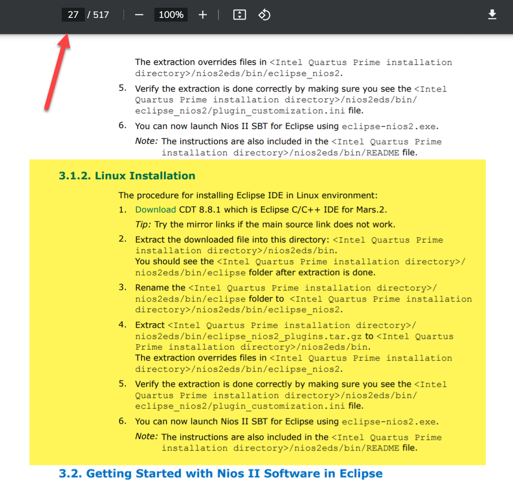

- EricMunYew_C_Intel
Can you refer to page 27 below for Linux installation:

I am very interested to hear if the installation details in Linux described in page 27 do solve the problem. I have actually been having problems in Windows with Quartus 20.1 and am in the process to install on Linux to avoid the use of WSL.
Thanks. James

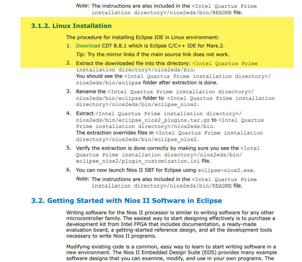

There is the issue that although the content link you provide shows limited Linux support for "supported OS" there is the general description of installation on Linux in the Nios II handbook as shown below . . .
That is taken from page 27. It says Linux, not just SUSE Linux.
James
