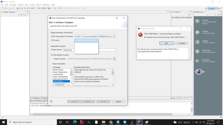

5 years agoproblem with nios2 application buildup error in quartus 13.0spi tool windows 10 operating system
1. i am new to quartus tool platform ,i am working with de2-115 kit ,i created niosii design imported to niosii eclipse platform ,when i am trying to build the nios2 bsp ,i am getting An inte...

For no1, please refer the KDB for workaround:
https://www.intel.com/content/www/us/en/support/programmable/articles/000085858.html
For no 2, can you check in Quartus design did you include "Nios II Processor" is in your project in Platform Designer, and have recompiled?
