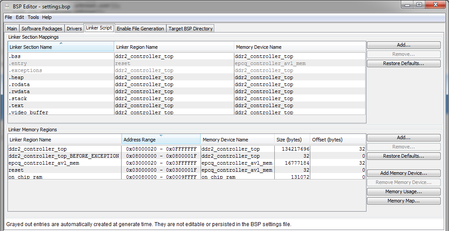

Hi! I need to create double buffer in my NIOS II project. I did it as follow:
static const uint32_t image_width = 768;
static const uint32_t image_height = 576;
typedef uint32_t gui_frame_t[image...

6 years agoHello,
One question how did you declare your video buffer?
- RSher116 years ago
I described video buffer creation process in my first post in this thread.
And I still have the issue and I try to solve it. I have one decision to allocate video buffer in the heap using malloc() without any additional sections.
