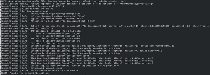

When trying to download an .elf file using the niosv-download command, the Open On-chip Debugger exits with a "Failed to read MISA from hart 0" message. Any idea what this is telling me?
I can successfully download elf file to the same Agilex when programmed with a different design, so I know the physical connections, etc. are OK. Full log below:

    This turned out to be an addressing issue. Once I changed my address map to the correct JTAG/UART address the nios-download operation was successful. It had nothing to do with OpenOCD versions.
