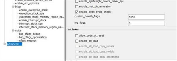

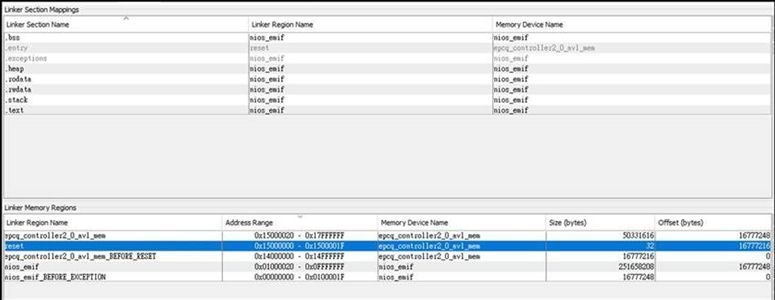

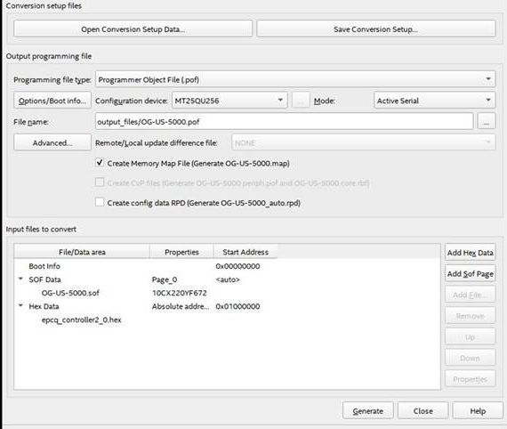

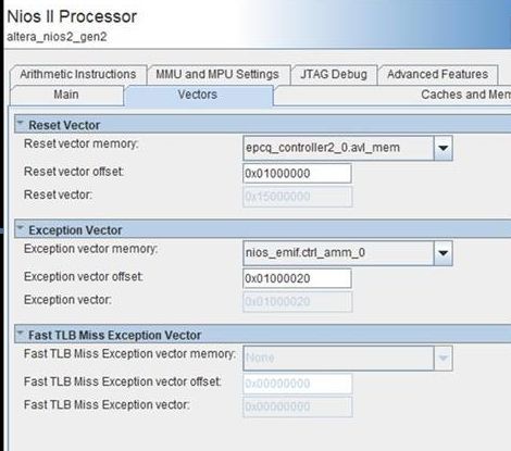

I am using Cyclone 10 GX for an embedded project with Nios 2.
Quartus Pro 19.2 + C 10 GX + MT25QU256
Here's my settings in Qsys,
Linker,
memory map,
pof generation,
For unknown reason, the Nios not boot after pof programming.
FPGA is fine, I download the elf to confirm the image is running.
I am not sure where is wrong in my configurations/ settings..
Any comments?
