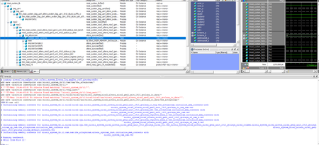

I figured out the problem, maybe it is a question too easy to be answered. the commands Nios II Eclipse send out are
Do load_sim.tcl.
LD
Change the ld to ld_debug will make all signals show up.
finally, I think I know how this Nios II Eclipse and Questa works. I would say, AN351 as a tutorial was a failure. I will give it barely grade C if it is a high school project. maybe there is good one which I don't know. maybe I should have read the "Quartus Prime Pro Edition Handbook Volume 1 ,2, 3" and "Nios® II Software Developer Handbook" line by line.
