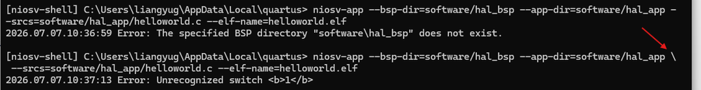

Thanks for pointing that to me , yes i was able to generate bsp as per document "AN 985: Nios® V Processor Tutorial" , But now i am stuck on this step :
See also attached my Niosv command console messages :
Any idea why niosv shell cannot recognize these switches ? Thanks
Try removing the backslash.
Able to replicate your issues when "\" is present."\" works as a line continuation character in Linux, but that doesn't work in Windows.
