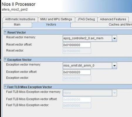

6 years agoNios 2 Boot Issue
Hi, I am using Cyclone 10 GX for an embedded project with Nios 2. Quartus Pro 19.2 + C 10 GX + MT25QU256 For unknown reason, the Nios 2 did not boot. I have to manually download the elf again thr...

6 years agoHi Eric,
Thanks!
Use the 0x0000_0020 offset value worked and jic file generated without problem.
But the program was not running after programming.
The error message while executing mem_init_gen, please see below.
By the way, I am study AN458 about boot copier.
It mentioned boot copier executes from the on-chip memory block in EPCQ controller..
How do I know it is working?
BRs,
