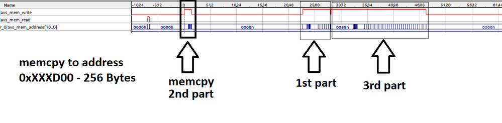

0xD00:
The write is splitted into 3 parts: 1st part and 3rd part happens when I use flush, the 2nd part is written while executing memcpy.

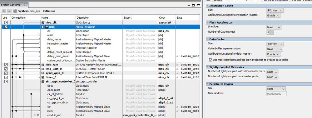

In the Platform Designer:
so no tightly coupled memory, just the zim_qspi_controller (the slave where I want to use the memcpy) and a nios ram (onchip memory) where my heap and stack is allocated.
