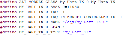

Hello! I am having difficulty using the IOWR and IORD functions in NIOS II. I have created a custom Uart Tx IP and I want to communicate with my computer through it. then, I have included it in NI...

Even after modifying the code according to your answer and debugging it, the same problem occurs.
I think the problem is that I made my CUSTOM IP incorrectly.
If it’s not too much trouble, could you tell me how to make a CUSTOM IP using the UART_TX HDL code I’m providing?
I will write my HDL code for this purpose. I will also attach other HDL codes I wrote to make it into CUSTOM IP below.
