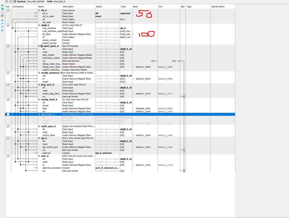

The above memory location is in Flash and I am trying to run from flash.Here is a screenshot of the Qsys system. The incoming clock on DE-10 is 50Mhz and I am using the PLL to generate 100MHz on which all the components are running.
I have added the clock constraints alone for timing without adding an input/output delay as at this point, I am not doing anything accessing external logic. - JayHarikumaran
I have attached the Qsys design file. The dual_boot ip allows maximum clock rate of 80MHz. I have updated that as well in case that would be the issue and it still throws up the same error.
