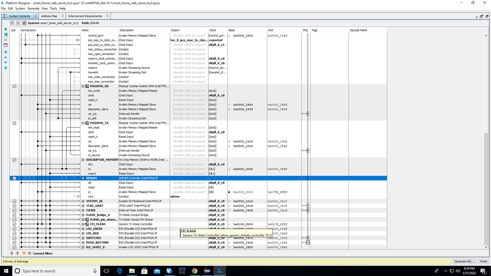

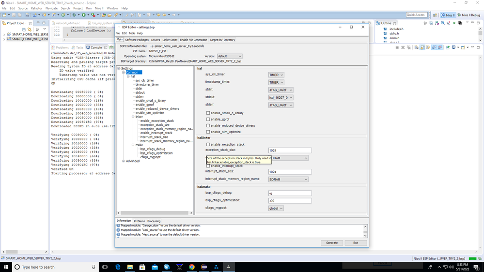

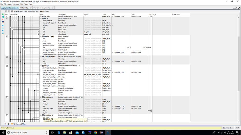

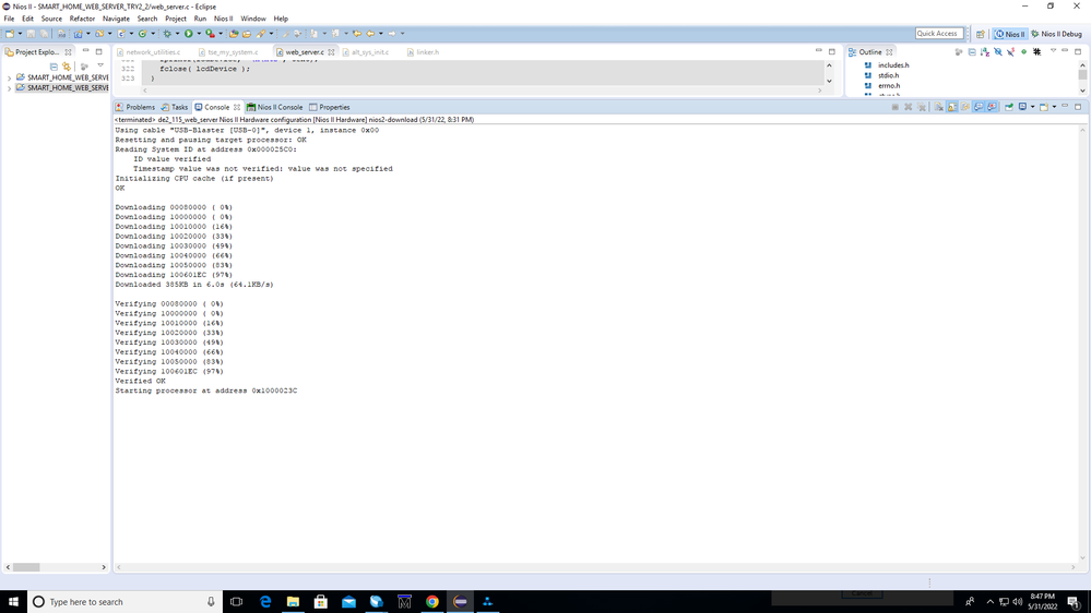

I have been working on this project for a while now for school work. I am using a TSE IP with MSGDMA using edition 18.1.
The system builds ok and says that it is running. But I am trying to get an IP address display on the nios ii console but it remains blank.
I have included my system from platform designer, and what I get when I ran the system.
If anyone could help, it would be greatly appreciated.
Thanks in advance.
SYSTEM FROM PLATFORM DESIGNERSYSTEM FROM PLATFORM DESIGNERI get nothing when i run the systembsp editor

Thank you for getting back to me. I have not resolved the issue. I suspect that I have an issue with the TSE MAC configuration. So, I am looking into that but no lock so far.

You can check TSE MAC configuration through example design in AN647. I have attached the link for your reference.
Kindly download the example design and unarchive, there is a file called "config.tcl", this file contains the TSE MAC register setting. System console will source this file to configure the TSE MAC register.
