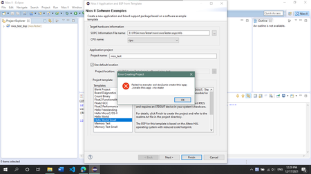

failed to execute: wsl dos2unix create-this-app

If it does not help, try to independently execute this command in the created directory (DirectoryName, not DirectoryName_bsp) and send a screen here.
