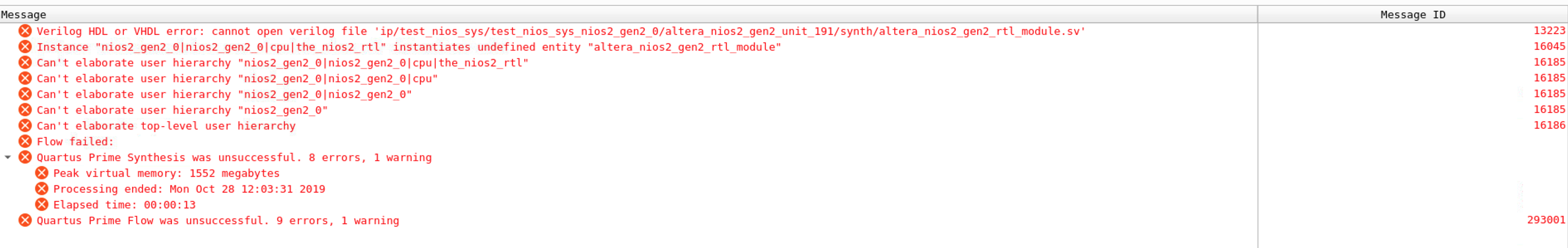

Error synthesizing Nios II design in Quartus 19.1

After you create the NIOS design in Platform Designer, did you save and generate the system? If not, generate the system and then close Platform designer , compile the design and check. It should work. Also make sure that the location where you have saved and generated the system is in the Quartus main project folder and not in another location.

Yes, I did save and generate HDL and it didn't work. The qsys file is in the same quartus project directory (ip folder is also in there). The thing is that if I follow the path, the file is there. I just don't know why Quartus wouldn't pick it up. It's an encrypted file though. I'm not sure if this could be a problem with this version of Quartus.

I think I figured out the problem. It has to do with FlexLM version. The alterad and lmgrd daemons running on the license server were old and had to be updated to v11.16.2. Thanks for responding.
