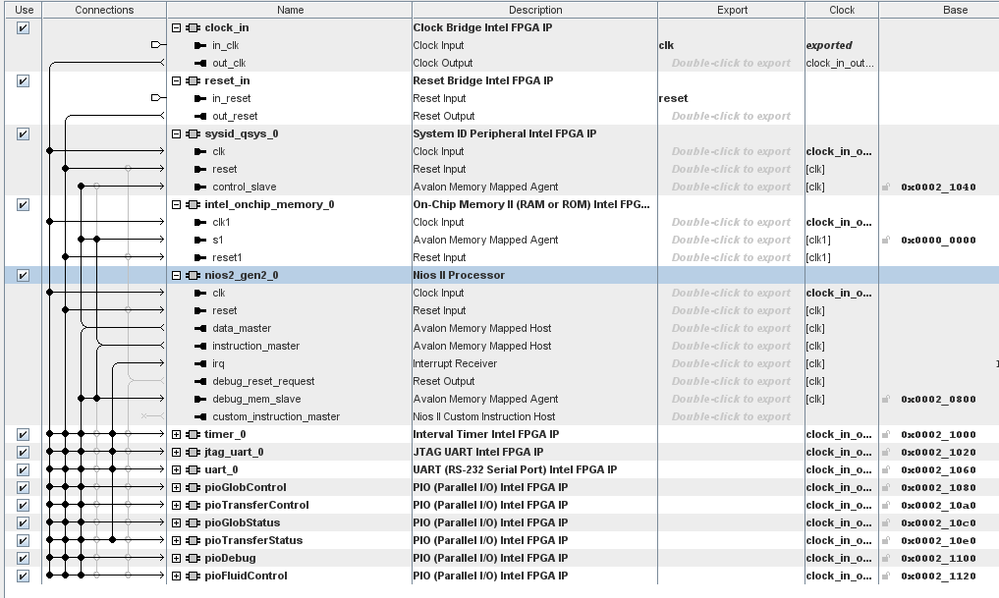

Fathulnaim- Oliver_I_Sedlacek2 years ago
Contributor
Aaargh, this is so frustrating! Your screenshot doesn't show what reset is connected to. At the top level I've connected mine to the development board fpga_resetn signal but as per my other forum thread I can't get an explanation of its functionality, see https://community.intel.com/t5/FPGA-SoC-And-CPLD-Boards-And/Cyclone-10-GX-dev-kit-which-signal-can-I-use-to-reset-a-NIOS/m-p/1539825#M26240 (BTW I can't post replies to this thread, another source of complete frustration)
In the mean time, here's a screenshot of my Platform Designer.
If there's any way to speed up this dialogue from 24 hour responses please let me know.
