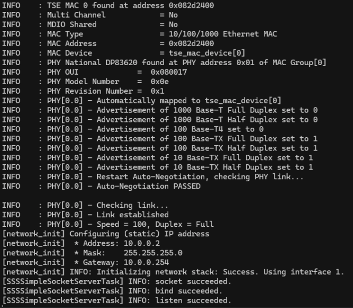

Hello ,
I am using a Cyclone 10 GX with Nios V and the Micrium MicroC/OS-II operating system. My setup includes the Triple-Speed Ethernet Intel FPGA IP paired with the Modular Scatter-Gather DMA Intel FPGA IP, connected to a DP83620 PHY IC.
Problem Description:
In my implementation, the auto-negotiation completes successfully, and the link is established as indicated by the PHY status registers.
I have configured an IPv4 address, subnet mask, and gateway using NetIPv4_CfgAddrAdd. Additionally, the socket() creation, bind(), and listen() calls in my socket server task all succeed without errors.
However, the system does not respond to ping requests from a connected PC using the assigned IP address.
Key Information:
The Ethernet MAC and PHY configuration seem correct:
Auto-negotiation and link establishment indicate that hardware connections are likely fine.
The MAC and IP address settings are successfully applied.
The Modular Scatter-Gather DMA is initialized and configured, but there might be a gap in how the RX/TX buffers and descriptors interact with the network stack.
Debugging Steps Taken:
Verified MAC, PHY, and DMA initialization logs.
Confirmed that the socket(), bind(), and listen() functions in the SocketServerTask return no errors.
Observed proper PHY register behavior, including link status and speed/duplex negotiation.
If anyone has experience with a similar setup or can offer suggestions on how to debug further or resolve this issue, I would greatly appreciate your input!

  • Paul36's avatar
    Paul36
    Hi JingYang,
    Thanks for your information and I have added the profile for the PHY and change the memory allocation of the DMA module and I can ping the IP now.
    Paul

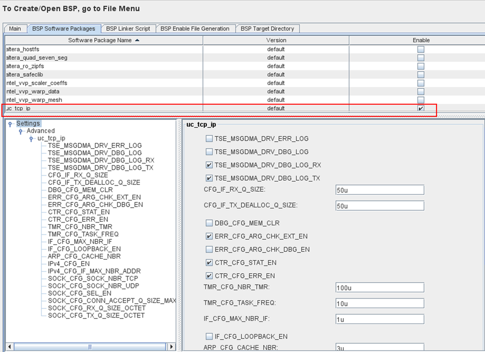

      Yes, I also follow the Arria 10 example's readme file command to generate the BSP as below, I think it already include the steps in the link you placed in previous post.
      Script from the Arria 10 example :
      niosv-bsp -c sw/bsp/settings.bsp --sopcinfo=hw/sys.sopcinfo --type=ucosii --cmd="enable_sw_package uc_tcp_ip" --cmd="set_setting altera_avalon_jtag_uart_driver.enable_small_driver {1}" --cmd="set_setting hal.enable_instruction_related_exceptions_api {1}" --cmd="set_setting hal.log_flags {0}" --cmd="set_setting hal.log_port {sys_jtag_uart}" --cmd="set_setting hal.make.cflags_defined_symbols {-DTSE_MY_SYSTEM}" --cmd="set_setting hal.make.cflags_user_flags {-ffunction-sections -fdata-sections -fno-tree-vectorize}" --cmd="set_setting hal.make.cflags_warnings {-Wall -Wextra -Wformat -Wformat-security}" --cmd="set_setting hal.make.link_flags {-Wl,--gc-sections}" --cmd="set_setting ucosii.miscellaneous.os_max_events {80}" --cmd="set_setting ucosii.os_tmr_en {1}" --cmd="set_setting hal.make.cflags_optimization {-O2 -fno-tree-vectorize}"
      Based on your example of migrating from Arria 10 to Cyclone 10 GX, could you help confirm whether the clk_enet_fpga_p pin (AB16) can be used as a regular I/O pin instead of LVDS, as I mentioned in my previous post?
      Additionally, do you have any insights on error 2010? I have already checked the reset pin in the project you sent me, and it appears to be present.

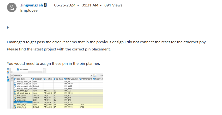

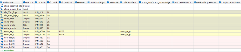

    • Paul36's avatar
      Paul36
      Hi JingyangTeh,
      Thanks for your project.

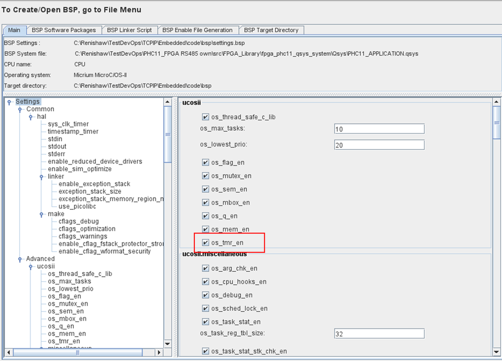

      I wanted to double-check with you regarding the clk_enet_fpga_p pin (AB16). Can this pin be used as a normal I/O(configure normal I/O in your project)? On the schematic, it is marked as an LVDS differential pin. I previously configured it as LVDS, but it seems there is an error indicating that pin AB16 does not support the HSSI reference clock. Could you clarify this?
      Additionally, are there any special settings required when generating the BSP?
      For reference, I typically enable os_tmr_en and uc_tcp_ip, while leaving other settings at their default values.
      Thank you, and I look forward to your response!

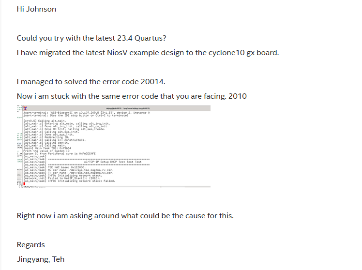

      • Paul36's avatar
        Paul36
        Hi JingyangTeh,
        I have tried your project but it have the error 2010 that I checked that you have faced it before.
        and I checked the reset pin already there from the project that you sent to me.
        Just see any other think I am missing.
        Paul
