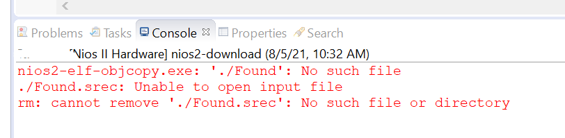

During compiling a project in Eclipse for Quartus 20.1 Standard Pro, I get the following message shown below.
However my program completes the compile successfully and runs as expected.
Actually this has been happening during the entire course of the project, and I am just wanting to confirm that there is not an issue here.
I am using WSL Ubuntu 18.04 on Windows 10.
Thanks. James

    Can you check if you have multiple workspaces in your directory, try to remove them and recreate again.
