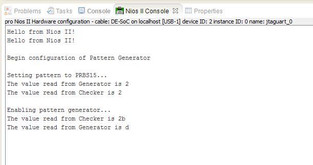

    Are you expecting output like below
    --- Quote Start ---
    Setting pattern to PRBS31…
    The value read from Generator is 2
    The value read from Checker is 2
    --- Quote End ---
    Are you trying to check the Enable bit?
    Then it's should have a value whose LSB bit 1.Example.
    --- Quote Start ---
    Enabling pattern generator…
    The value read from Checker is 2b
    The value read from Generator is d
    --- Quote End ---
