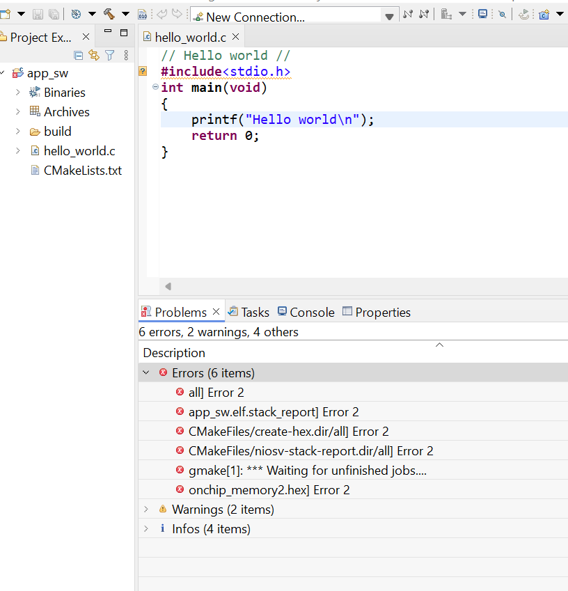

Ashling RiscV NiosV errors
Hi I am trying to compile a simple hello world on NiosV targeting a CycloneIVE FPGA on DE2-115 board p/n : EP4CE115F29C7. But when i build project in Ashling RiscFree i get these errors which i dont have any idea what these referring to :

Can anyone help me resolve this issue .

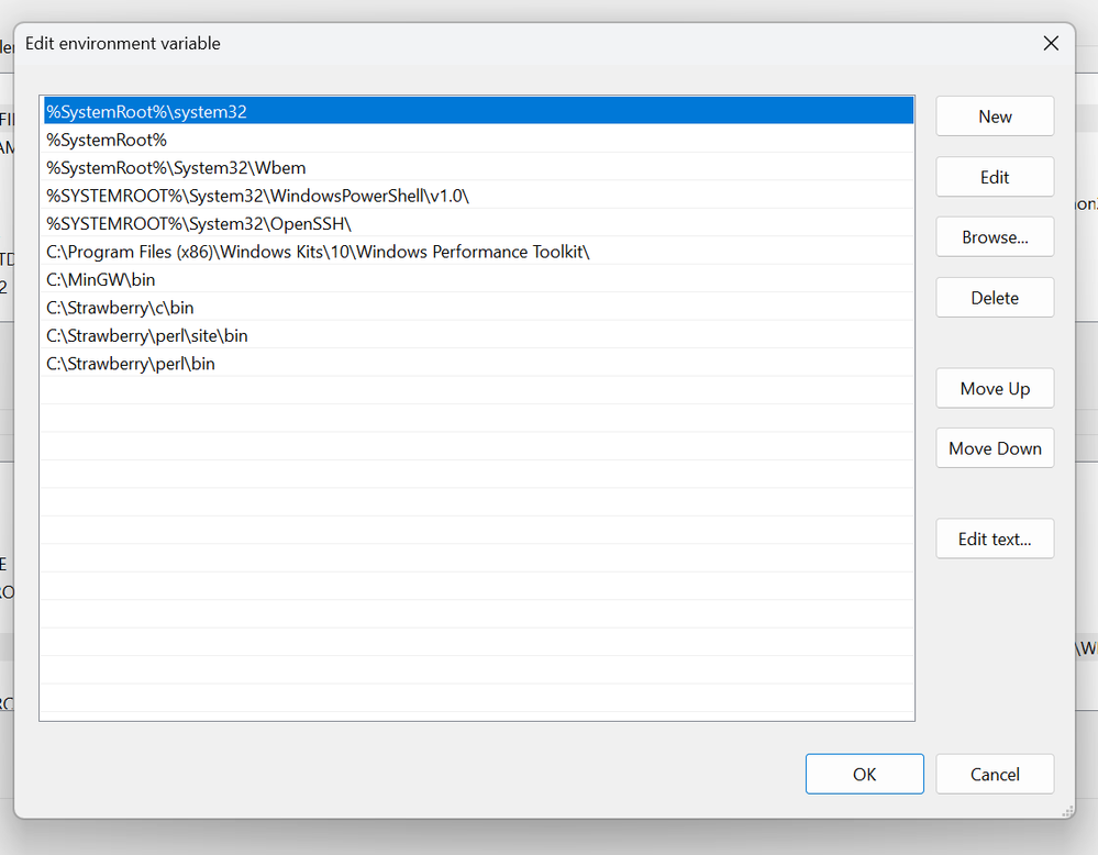

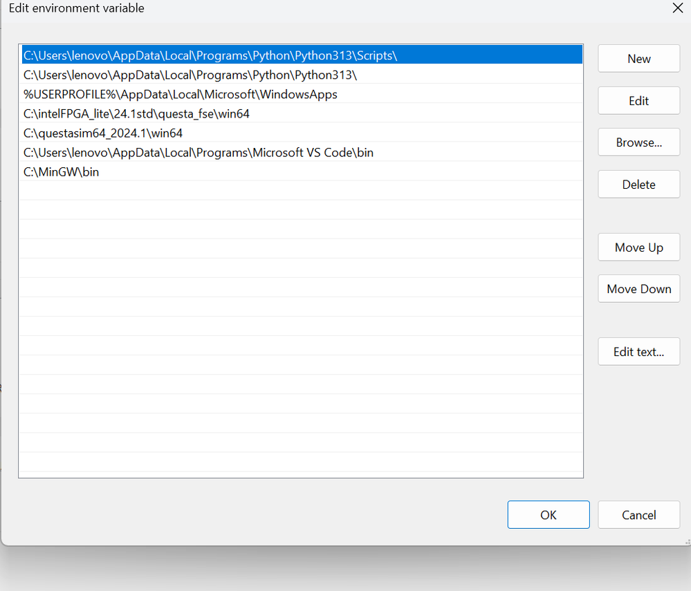

    • Fpga_Egr_2025's avatar
      Fpga_Egr_2025
      Hi , i was able to compile my design for the NiosV targeting CycloneIVE FPGA on DE2-115 board p/n : EP4CE115F29C7.
      But now the JTAG debugging is not working, i searched the forums for that issue and it seems that clock speed has to be double of what system clock is i.e 50Mhz .
      See screen shot attached.
  • Hello @Fpga_Egr_2025 ,
    Please make sure that NIOS-V BSP or NIOS-V APP absolute path is in the environment variable PATH.
    Thank you.
    Girisha Dengi
  • tazzo2's avatar
    tazzo2
    Do you have YOUR_PATH/altera/YOUR_VERSION/niosv/bin on your path? Seems can't call the tool niosv-stack-report
