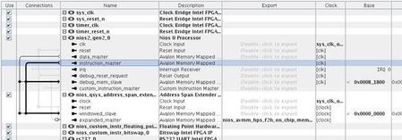

hi, What is the correct way to implement the Arria 10 HPS on-chip RAM to act as my instruction memory for my NIOS II processor. Currently I’m using an address span extender as a bridge to the fpga-...

The span extender gives the address of the slave memory as 0x00 but this maybe isn't the address of the memory on Qsys. Please check the correct address.
