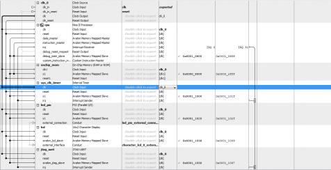

In Qsys the lcd is named lcd, so i think "/dev/lcd" is correct. You can see a screenshot of my Qsys Sytem as Attachment. Or here in higher Resolution: http://abload.de/image.php?img=displayqsysr5jmu.png This is my system.h: # ifndef __SYSTEM_H_# define __SYSTEM_H_

I think the IP Core is working and the Display is wired correct, because the Cursor of the Display is blinking. Greets Olaf2 Replies
