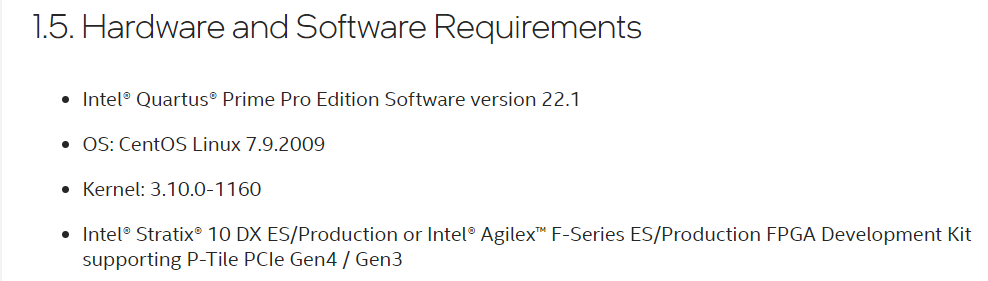

- Wincent_Altera
Hi Chunxi,
For the P-tile Avalon® Streaming Intel® FPGA IP for PCI Express* Design Example
If referring to the user guide Session 1.5. Hardware and Software Requirements
For this specific IP/Design it only supports CentOS Linux at the moment.
Will update you if there is any change in the future.

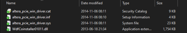

I checked further in FPGA Design Store | Intel and found there is a Windows driver for Arria10/StratixV PCIe AVMM IP DMA.
- Arria 10 AN690 PCIe Gen3x8 AVMM DMA with On-Chip Memory: https://www.intel.com/content/www/us/en/design-example/714458/arria-10-an690-pcie-gen3x8-avmm-dma-with-on-chip-memory.html
- Arria 10 AN708 PCIe Gen3x8 AVMM DMA with External Memory: https://www.intel.com/content/www/us/en/design-example/714462/arria-10-an708-pcie-gen3x8-avmm-dma-with-external-memory.html
- Stratix V PCIe AVMM DMA Gen3x8 On-Chip and External Memory: https://www.intel.com/content/www/us/en/design-example/714937/stratix-v-pcie-avmm-dma-gen3x8-on-chip-and-external-memory.html
But the driver does not contain source code because it is used under the GUI delivered along with the driver.
Could anyone share if there is source code available? So I can find some way to develop Windows driver for Agilex PCIe DMA usage?
