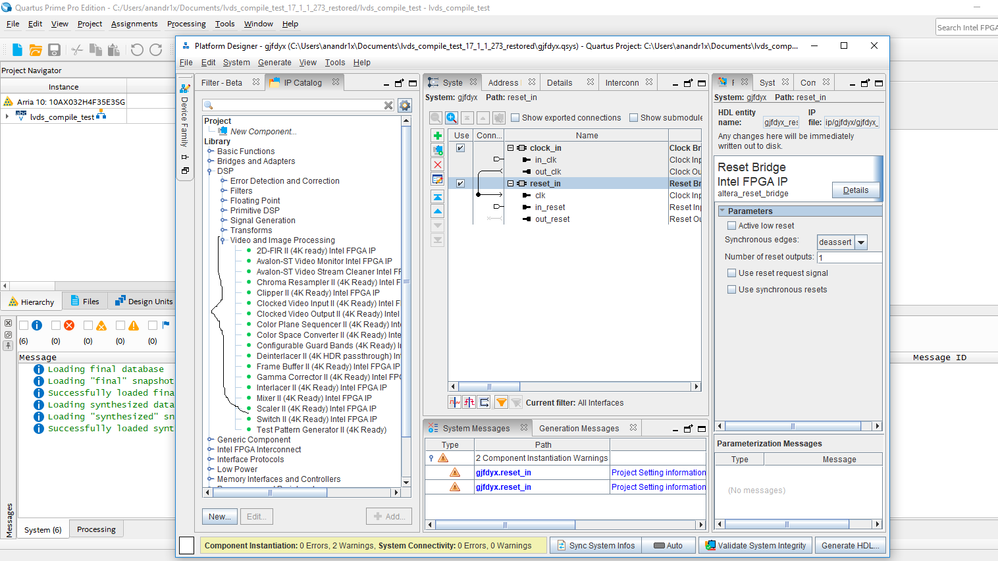

- CheepinC_altera
Hi LSant1,
Please correct me if my understanding is incorrect, you are observing that after installing the VIP suites, when you open up the IP Catalog, you are unable to locate the VIP IPs under the IP catalog. If yes, for your information, you may try to look into the library in Qsys at Qsys -> Library -> DSP -> Video and Image Processing as shown in the above screenshot for Q17.0. For your information, VIP IPs are only available in the Qsys a.k.a Platform Designer (in Q18.1) library but not in IP Catalog.
Please let me know if this is helpful. Thank you.

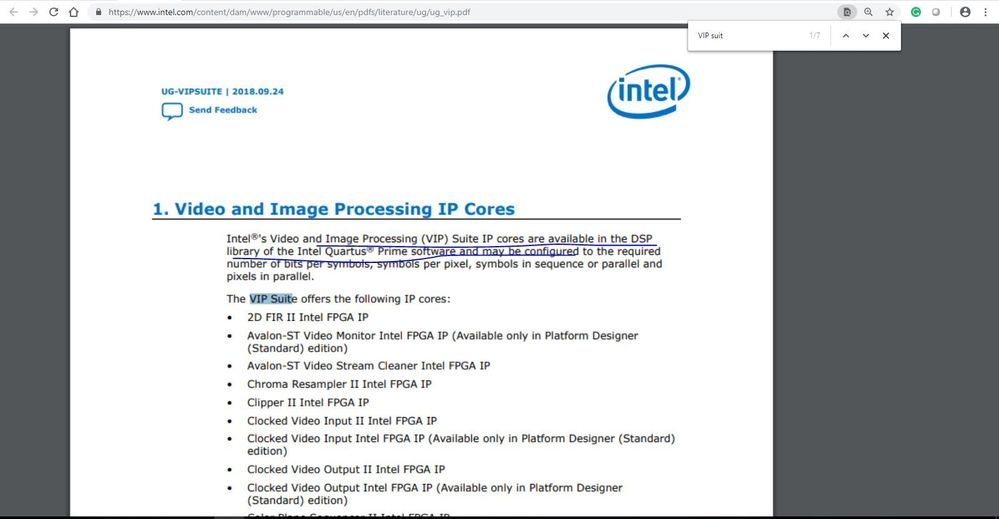

- Vicky1
Refer the below from user guide,
Check under Tools->Platform Designer->IP Catalog
Best Regards
Vikas Jathar

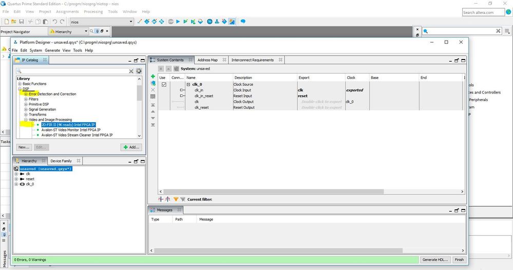

- Vicky1
Generate/Create project in Platform designer,
Here I used Q18.1 pro with Arria 10,
Best Regards
Vikas Jathar
