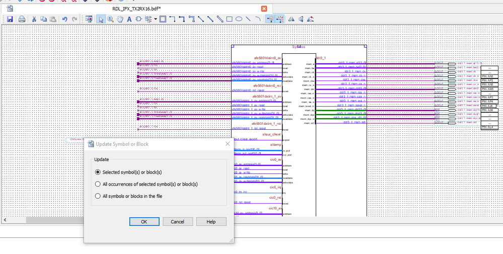

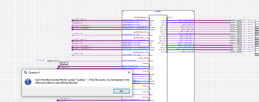

And from that when we take and copy that project for changing purpose, if there is no any peripheral related connections change we need to not to update any schematic of the project of the project but if we need any change the following error is coming:
To correct this error I(@venkatesh) was adding project path into library as follows:
and then update of the IP in the schematic happens sucessfully:
