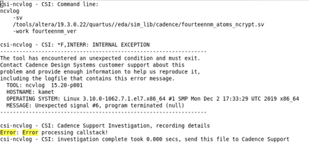

6 years agounable to compile libraries for emif IP in quartus 19.3 in cadence.
I tried to compile libraries for EMIF IP generated from quartus 19.3 version device used stratix10. While running the command ncsim_setup.sh. It stoped follwing the error attached.
Deshi_Intel
6 years agoHi,
Can you help to clarify further on your problem statement ?
- Which ncsim version that you used ? Byright Quartus v19.3 should pair with ncsim version 15.20.074
- Are you running the sim using EMIF example design ?
- If yes, which EMIF protocol that you used and what's the DQ width ?
Once you clarified on the info then I can try run the sim from my side to see whether I can duplicate your issue or not
