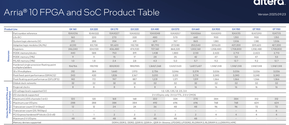

What is the maximum data rate supported by A10 GT device?

I think this table answers your question
