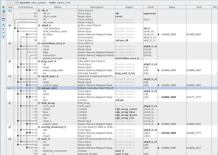

4 years agoSystem not working when SDRAM Controller on Databus
I'm creating a system on Cyclone 10 with a RISC-V Processor from Vectorblox (orca-1) . The idea is to have a Bios on the onchip memory, which initialises a serial connection (UART). This serial conne...

At the end it turned out, that the default start up code did not initialized the stack pointer properly. I implemented my own startup code, where I initialized the stack pointer so it points to the correct location. After that the system worked as desired.
