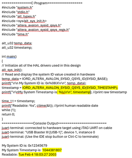

I would like to get compile timestamp using System ID Peripheral IP (ver: 19.1.8) which is connected to NIOS-V IP (26.0.0). I am using Quartus Prime Pro 25.1.1. Using the NIOS program I am able to co...
