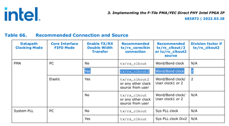

4 years agoSupport logic conflicts with F-tile PMA clocking and double-width 16b (Quartus Pro 22.1)
I tried to set the F-tile:
PMA Direct
PMA clocking
PMA width 16b
TX and RX double-width enabled
Qsys doesn't complain and I can generate the files.
From the user guide, it seems poss...

4 years agoHi @Kshitij_Intel ,
The IP is in my first message, could you confirm the IP's configuration is allowed.
