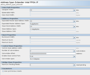

Figure 23 in this document.This design, which includes the Nios processor, Address Span Extender (ASE) IP, and PHYLite IP, is intended for on-board testing.
I used the ASE IP because the Nios II processor supports only upto 32b.
To enable the Avalon Memory-Mapped interface in the PHYLite IP, I have configured the IP with dynamic reconfiguration enabled.
