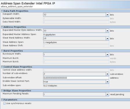

Therefore, you can connect directly to NIOS with Address Span Extender IP.
