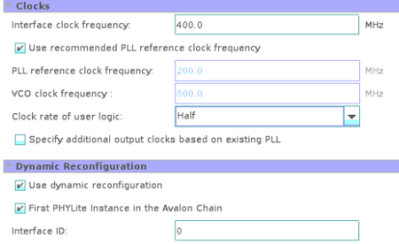

1 year agoStratix 10 Phylite IP , deviation in data sampling at different groups(Input Path Signal)
Hi , Configuration detail: Problem Statement: For group 0 data is sampled correctly as expected but for group 1 data to core signal the data sampled internally by phylite is shif...
Ash_R_Altera
1 year agoHi,
I think there might be something to do with the read latency. Please follow the guidance on the following webpage:
NMR
1 year agoHi Ash_R,
Thanks for your consideration.
I checked this PHY Lite IP configuration settings with the example simulation design where I did not encounter this issue
