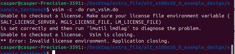

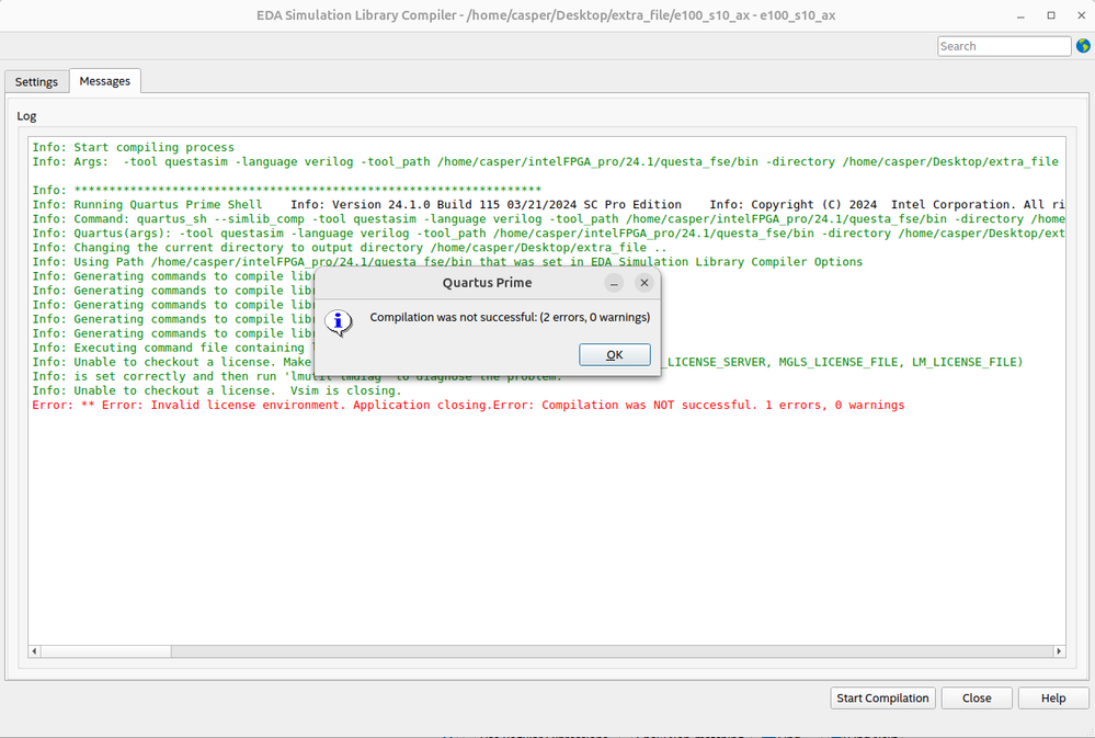

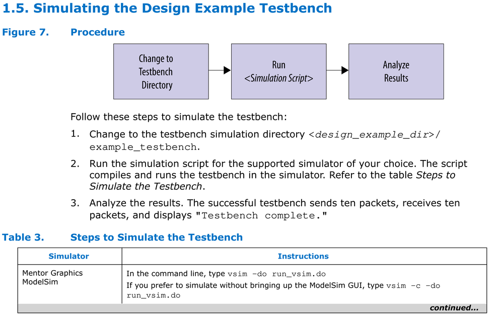

- I have a Platform Designer file where I have designed my signal processing design. This design will produce a lot of data, and I want to stream it to 100GBE. I read the document about the Low-Latency 100Gbe Ethernet IP Core User Guide and the Low-Latency 100Gbe Ethernet Intel Stratix 10 FPGA IP Design Example User Guide. In User Guide 1.5, there is a simulation of the design example testbench, which is not working as expected. It is asking me for a license, which I already have; I even gave it the license path in the command line terminal.

This looks like the environment isn't set correctly.
Please follow the steps mentioned in this User Guide and retry the simulation.
https://www.intel.com/content/www/us/en/docs/programmable/683472/25-3/and-software-license.html

Hi Altera,
I didn't know I had to create a separate license file for this. I thought one license file should be enough.I will follow this step.
export SALT_LICENSE_FILE=<path to license>:$SALT_LICENSE_FILE
