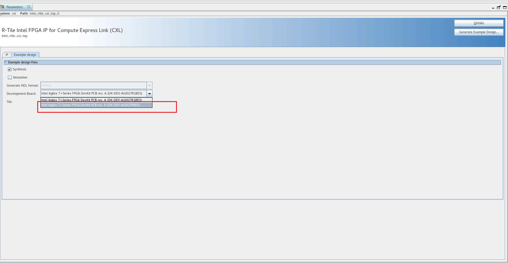

For DK-DEV-AGI027-RA, u can generate example design in quartus for DK-DEV-AGI027RBES, and change the device after example design generated.
