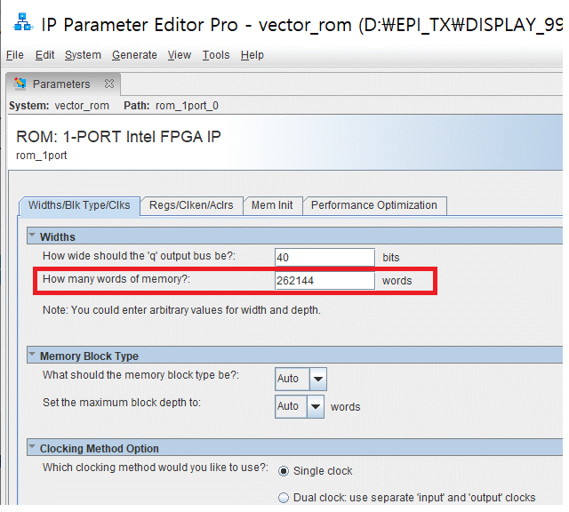

In following figure,
It says "262144 words."
You say words is 8 bit
So 40 x 8 x 262144 = 83,886,080
Is this memory 83,886,080 bits?

- RichardT_altera
Let me rephrase my previous reply. By default , the bit of memory is set as 8 when you open the IP and you can change the number of bits in the 'q' output width.
Referring to the screenshot that you attached, you are setting 40 bits with 262144 words.
So the total memory bits will be 40 x 262144 = 10,485,760. You can verify it by checking compilation report. Fitter > Resource Usage Summary.
