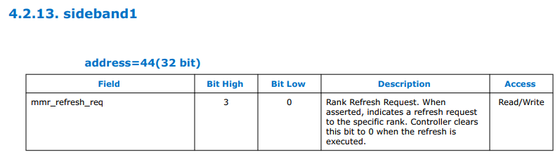

The EMIF example design do not control the MMR interface to perform user refresh.
So user needs to add the user refresh control logic into the simulation to perform the user refresh.
Please refer to register in picture below to issue a user refresh request.
