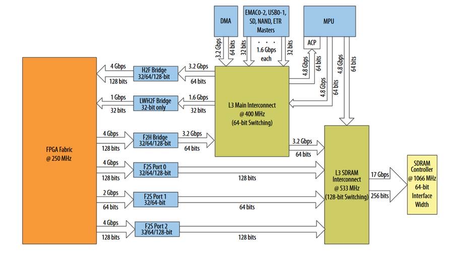

Sorry. I am confused on your calculation.
In theory, DDR3 or DDR4 BW can be calculated using below formula.
DDR3/DDR4 BW = operating freq (MHz) x 2 x DQ data width
From your diagram, I can see that the theoretical BW will be 1066MHz x 2 x 64 ~ 17GBps
Adjusting FPGA core clock frequency will only affect the speed where user transfer data to DDR3/DDR4 IP but it will not change the BW of the DDR3/DDR4 IP unless you change the operating frequency or DQ data width.

Yeah I also mean that only when I changed Fpga core clock from 100MHz to 200MHz I should suppose to see double the rate of 8.88Gbps which I was getting previously why because DDR3 I have configured is for 600MHz for 32 DQ bits i.e.., 600MHz*2*32 = 37.5Gbps.
Where as through fsdram0 bus when I connected for 100MHz also I see same 8.88Gbps and for 200MHz also I see same 8.88Gbps which is very strange.
