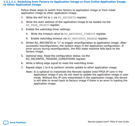

I'm trying to integrate the Remote Upgrade IP in Cyclone V without an Avalon bus and I have two questions:
1) Do I need to integrate the Remote Upgrade IP in the factory design with a state ...

Yes you can do so by reading the "pof_error" indicator before you trigger reconfiguration on steps 4.

I did it =).
Another question, if I give a wrong address to the Remote Update IP, how many addresses the ASMI Parallel IP will search before the "pof_error" indicator will turn on?
