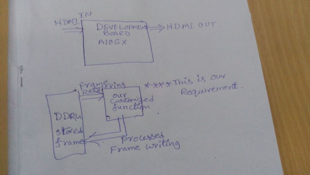

      Please see the attached functional diagram.It is our requirement. Please provide your guidance for the following required functional implementation. 1. Frame Buffer Accessing in the VIP Control Source code for implementation of our customized conversion. 2. Brief description for VIP based nios2 functions and passing parameters. Functionalities to be implemented in the FPGA: 1. Display Data receiving from HDMI Receiver. 2. Stored Frame content from DDR4 sdram to be retrieved. 3. Implementation of customized conversion process. 4.Storage of conversion data to DDR4 sdram. 5. Sending converted video data to HDMI Transmitter. Thanks and regrds D.SUVARNA
      Pls guide me .
      Thanks and regrds
      D.SUVARNA
